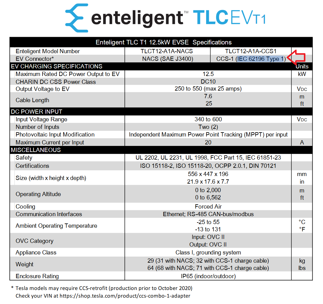

I see a device is about to be marketed that is the solution I was looking for. A solar ev charger that takes dc from panels and without conversion to ac directly can charge an ev. See Enteligent™ TLCEV T1 - Trusted Charging - Pre-order Deposit
I would be interested in any comments. Unfortunately looks as if can only preorder from the USA.
@BJT, This sounds like a great product. However, it is only available with CSS-1 (Type 1) connector, not the universal CSS-2 (Type 2), which is now used by most countries.
It would very be interesting to hear from anyone who has used this device.
