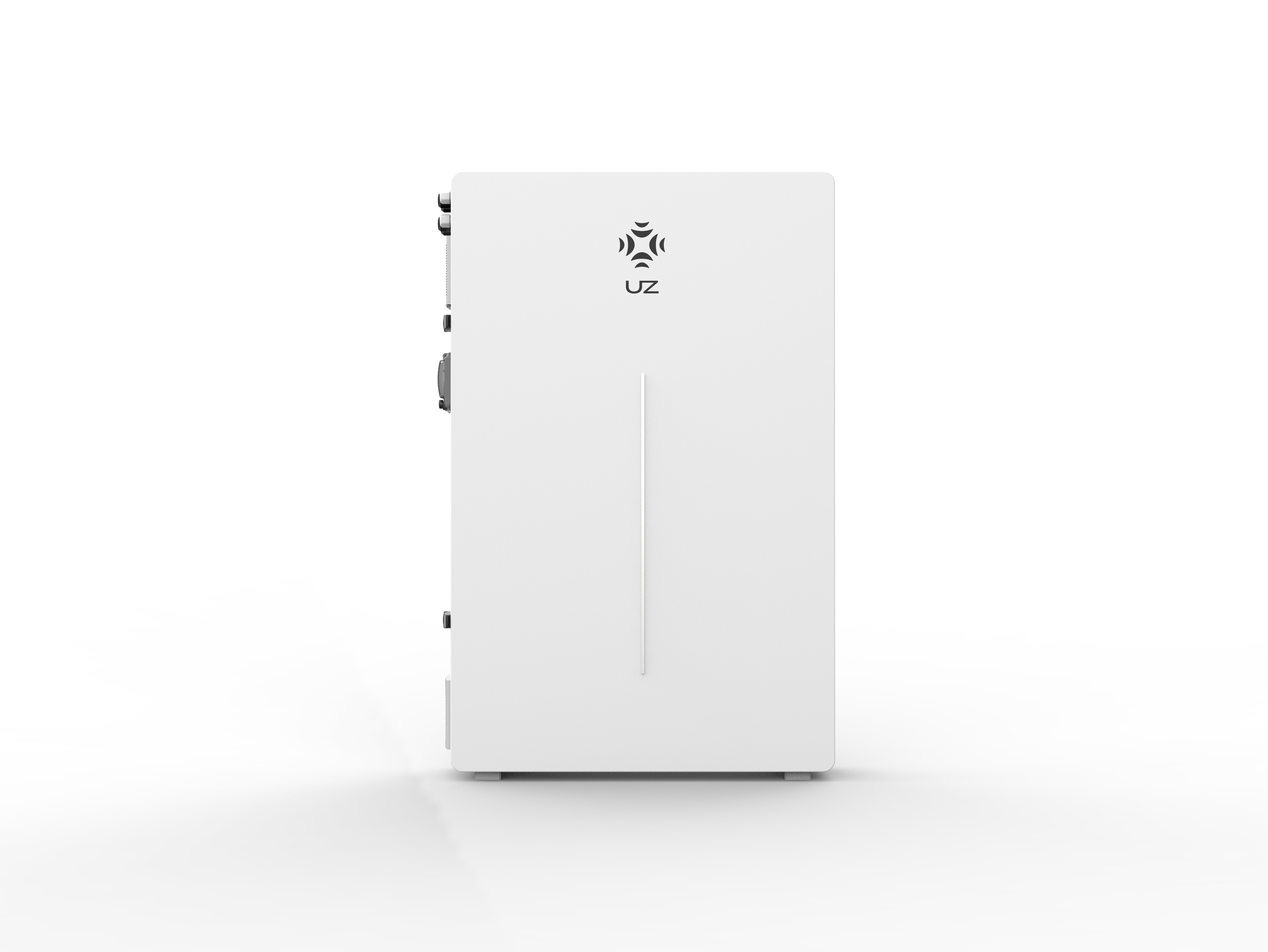

First of all, LFP is more secure. When we were doing UL9540A certification, we heated a cell externally, and the thermal runaway of this cell did not cause thermal runaway of other cells.
Then when using a lithium battery, be sure not to overcharge and overdischarge and other operations that endanger the battery.
Finally, our HESS bought insurance just in case.
