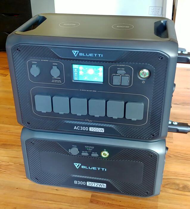

First impressions
I was immediately impressed with the unit’s quality, finish, and clever design when opening the boxes. It’s reasonably heavy and feels very durable with solid moulded handles. The AC300 has a clear colour touchscreen display, Bluetooth and Wifi control options, and a large power button. The unit features seven 10A 240V outputs and numerous inputs, providing multiple ways to charge the battery. The modular B300 battery is very well-built with the same integrated handles and a capacity of 3.07kWh (3072Wh). It can work as a stand-alone unit providing basic DC power via the 12V outlet and USB connections. Up to 4 batteries can be connected, providing a maximum capacity of 12,3kWh. The cost is very reasonable considering the high build quality, powerful inverter, durable design and impressive range of features.

Unlike most other power stations, the Bluetti AC300 is not an all-in-one system containing an inverter and battery in one unit. This system is unique because the inverter is separate and must be connected to a battery module to operate; it has no built-in battery capacity. The reason is that it is a powerful, high-capacity system, and it would simply be too heavy if the battery and inverter were combined.
Interconnecting cable
A large bulky cable is included to interconnect the AC300 with the B300 battery. It protrudes and looks quite cumbersome, but it is understandable, as the cable carries a lot of current and must be large and durable. It is one of the few design features that could potentially be improved. However, the flexible cable does allow the power station and battery to be stacked or positioned side by side.

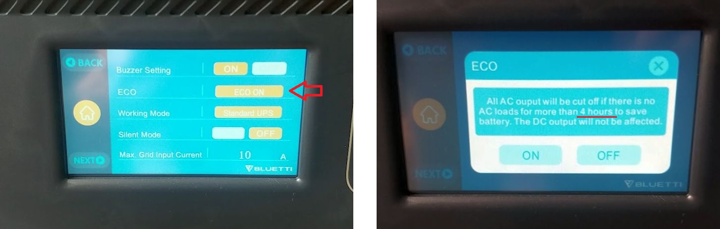

One of the few negatives of the AC300 is the higher than average standby power consumption. When in idle mode with both the AC and DC output switched off, it uses very little power. However, when the AC output is switched on, the idle power draw (with no load) appears to be close to 60W, which is high. Most power inverters typically only draw 25 to 40W under no load, so this is close to double. When left on for 4 hours with no load, it consumed around 8% of the battery, which was rather surprising.
Fortunately, there is an ECO mode that automatically disables the AC output if no load is detected. However, it has a 4-hour delay, which is a long time. I would much prefer a 1 or 2-hour cut-off point, but unfortunately, the time is not user-adjustable. I would hope a firmware update would enable users to choose a preferred time.
Other (smaller) Bluetti units have the ability to set the eco shutoff separately for both AC and AC, as well as time from 1-4 hours, or never.
That’s interesting. It’s strange that this model doesn’t allow you to change the ECO shutoff time, unless it’s hidden in another menu somewhere?
