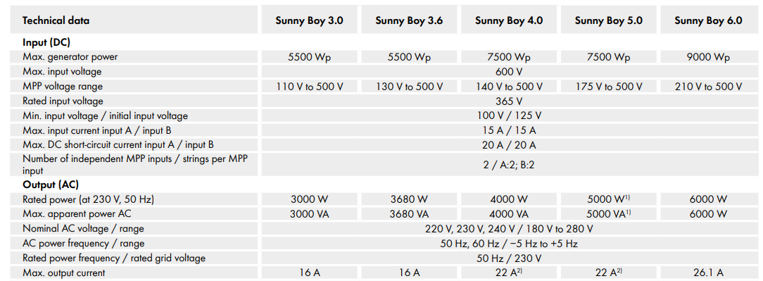

Thanks for your reply. The confusion around of the 4600w comes from the data sheet for the SunnyBoy, where they state the following:
Maybe im reading it wrong :slight_smile:

Oh, good detective work. AS4777 is an Aus/NZ standard, but VDE-AR-N 4105 looks like an EU or German standard, so presumably it would only be programmed in if the unit was solar in the EU, but I don’t know. You’d probably need to speak with SMA to confirm.
