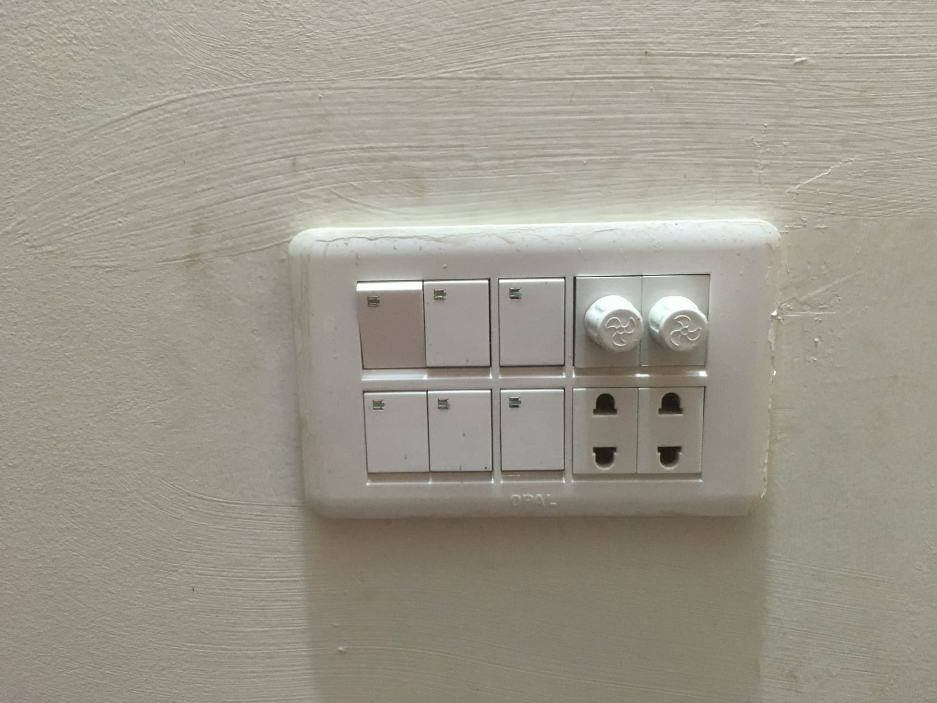

Hello friends, I have mistakenly used AC 7/0.29 (2.5mm) wire . It’s coming from controller to each room sockets (3 rooms) and then 1.5dc wire to lights and fans. The issue is the main wire is AC 7 copper conductors. And the distance is also 80 feet of last room and veranda fan. which Dc wire I should used (mm)? AC wire waste a lot of energy and low battery backup issue. please recommend me best gauge wire.

I mean I used wrong wire for DC setup, at my home one socket board have both electricity AC and DC, DC for fans and lights and AC for sockets switches to charge mobile, freezer, washing machine etc. AC wire has more resistance, so 12v dc loss energy when travelling in AC wire, now I am thinking about 4mm or 6mm wire. But hard to pull it in wire pipes. I also change wire to battery and controller, bought 16mm dc and removed AC 7/29 wire. 16mm is more powerful and no loss. I am installing more DC ceiling fans as summer is coming total 10 DC ceiling fans and 30 dc lights. In Pakistan light disappear for hours so
