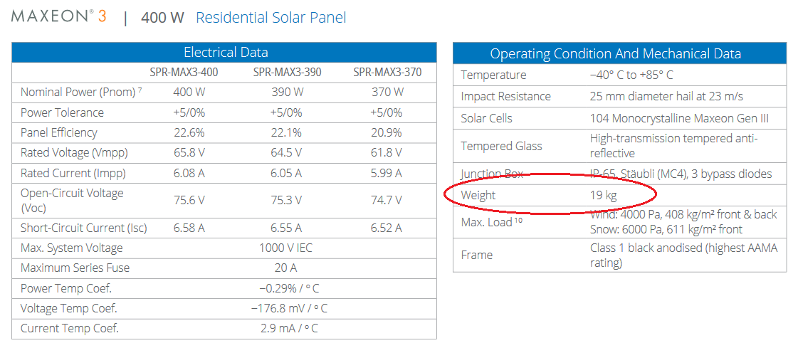

Most solar panel datasheets list the panel weight in kg (see example below). Most 300 to 450W solar panels weight between 18kg and 25kg. Although, there are flexible panels which are might lighter.

@QDP, if you want the maximum solar power from your limited roof area, then you need to use the most efficient solar panels you can afford, not the largest most powerful panel. If you can fit 1 or 2 smaller more efficient panels, then you would have more total kW overall. The Sunpower Maxeon 3 panels are still the most efficient panel in the world, and also the most durable.
Agreed. I like Max3s. Sol Ark 5k and 10kW batts. Some new “Blue” panel Bifacials are supposedly coming to market now. Wait on the increased 28% eff. this year?
@QDP I have used and tested some first-generation bifacial panels, but they only increase efficiency when mounted at a 30 to 45 degree angle on a light coloured rooftop. When I mounted them flat on the roof (about 3 inch offset) they didn’t appear to have any benefit. I’d just go with the Max3’s

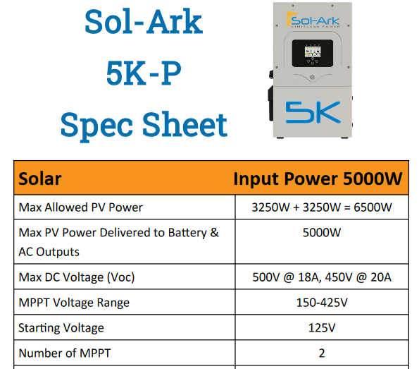

Good Advice, thx! Max3s it is, then add a Sol Ark 5k (overkill with 10kW Lifego batts ?) , of use the T Powerwall INSIDE horizontal (keeps my ass cozy warm, LOL!) under sofa? Advisable to mount it flat, or NOT A GOOD IDEA for ventilation? Like passive, not forced ventilation. Also, Like it indoor RV instead of under floor outside, to keep temps reasonable, but maybe too much storage for too little use. Or just go with someones full system, save some bucks?
Yeah, just go with a Sol-Ark and modular LFP battery system of your choice. You cannot use a Tesla Powerwall because it must be AC-coupled with a solar inverter to operate. Also, it cannot be mounted flat and would void the warranty
Ventilation is very important for any inverter, but the batteries just like to be at a stable temperature (not too hot and not freezing)
If using Sol-Ark, you need strings of panels with a minimum Vmp of 150V. (Min 3 x Sunpower Max3’s in series)
