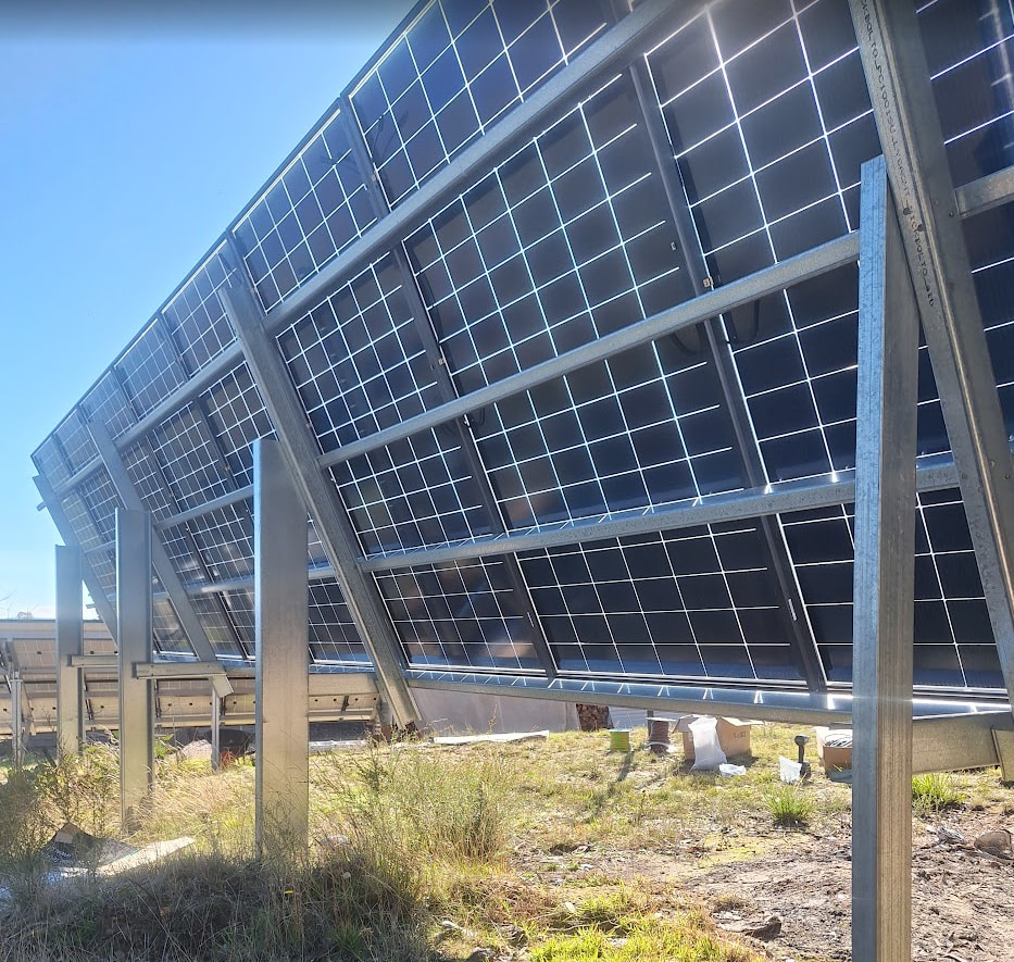

The best application for bifacial panels, based on what they are designed for, is a ground mounted with a light coloured surface (light sand, rock, or snow) or mounted vertically or near vertical) in an east/west orientation so the morning light hits one side and the afternoon light on the other side (as shown in the attached photo).
