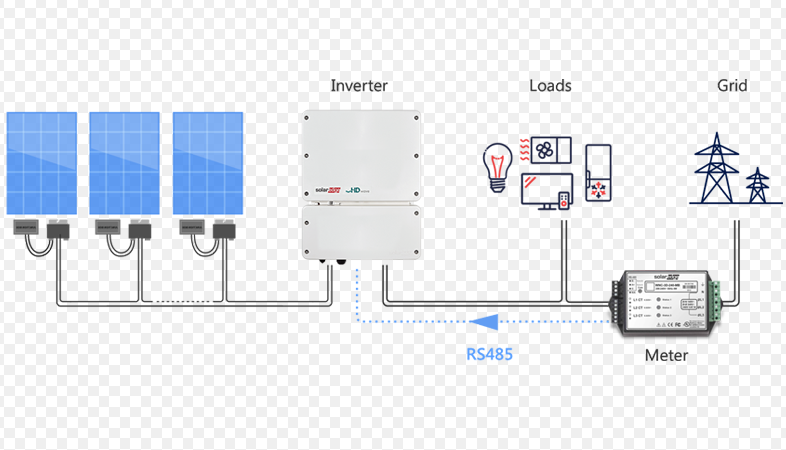

Hi Suntric,
It’s actually quite a simple device to export limit.
An ‘energy meter’ is used to measure total energy flow to and from the site. The energy meter uses a ‘current transformer’ (CT) which is clamped around the main supply cable and measures the current flow in either direction.
The energy meter (CT) is connected to the solar inverter and lets the inverter monitor the consumption and how much energy is being exported. The inverter can limit the amount of solar production based on the set export limit.
Below is an diagram from solarEdge
