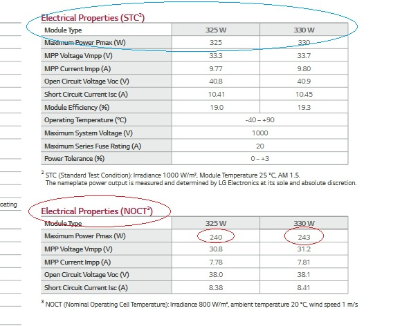

Below is the spec sheet for LG Neon 2 panels showing the STC power rating and the NOCT power rating below.
Wow that’s a massive difference. I thought STC was ambient temp not module temp. So you can expect a 20% loss in a perfectly nice 20C day? That’s seems like a crazy high derating?
But it’s also only using 800W/m2, which would be maybe ave across the day for decent install?

Marty you wouldn’t normally get a 20% loss on a 20 degC day, but around 10-12% loss is pretty standard (with no wind).
The STC is based on 25 degC ambient temperature at midday (1000W/m2) for a few seconds. In real world the internal cell temperature increases to 35-40 degC within 5-10 minutes and derates accordingly, this is normal and why is makes more sense to oversize the PV as much as possible.
