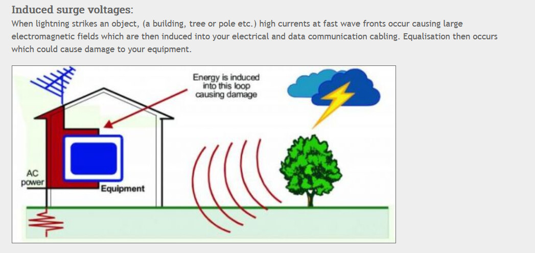

There are many different surge protection devices available for both DC and AC circuits. It would be good to find the exact source of the surge (or EMF?) https://www.phoenixcontact.com/en-au/products/surge-protection
This article contains some really good information and diagrams about lightning-induced emf and voltage surges.
