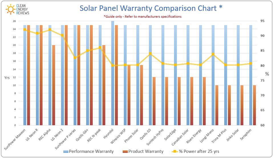

Here is the latest Solar Panel Warranty comparison chart - As of Oct 2019
The yellow line indicates the minimum power rating after 25 years of use as specified under the various manufacturers performance warranty documents.

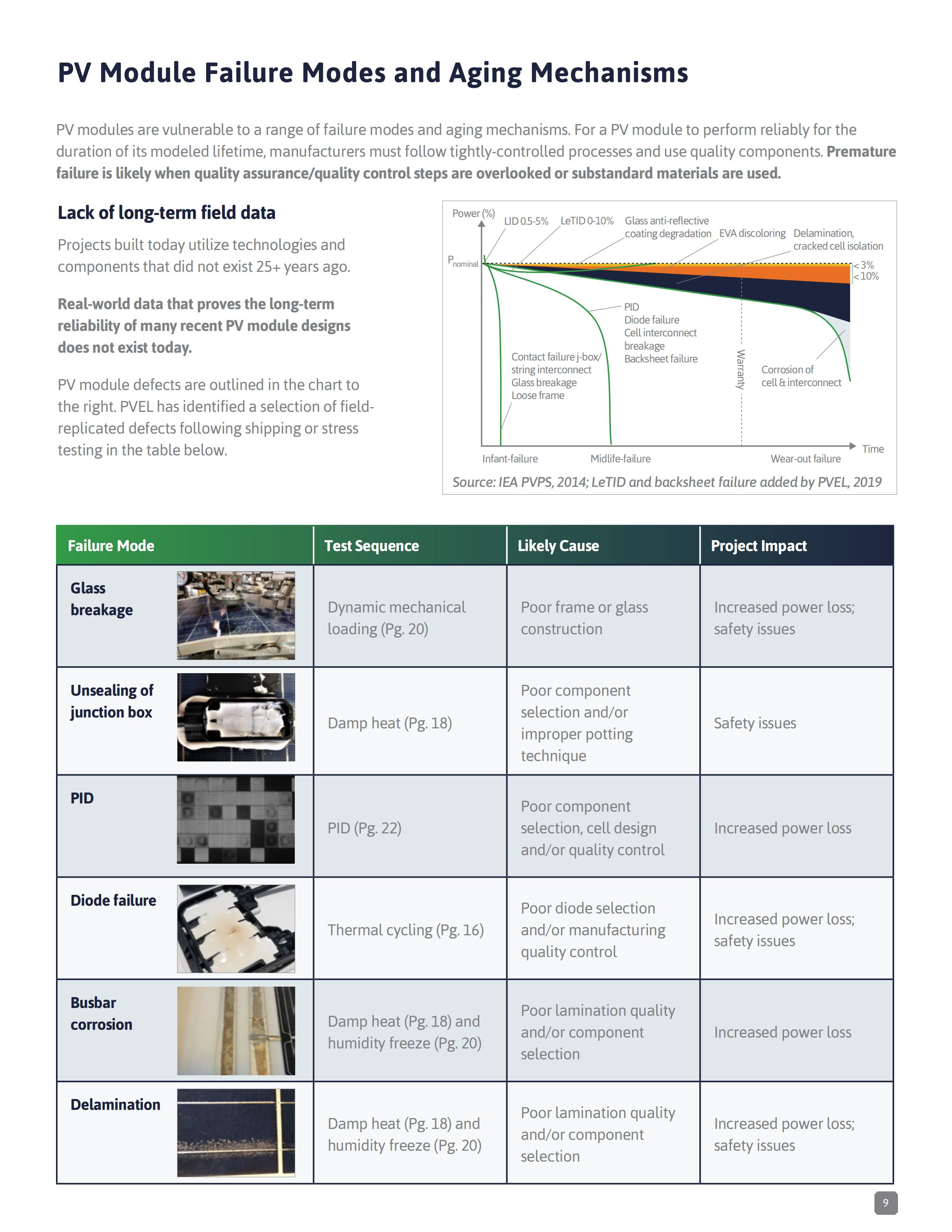

You can make a huge module, the question is why? The CEO of the PVEL laboratory says not to promote the large size of silicon and modules. Large size is more likely to fail.
